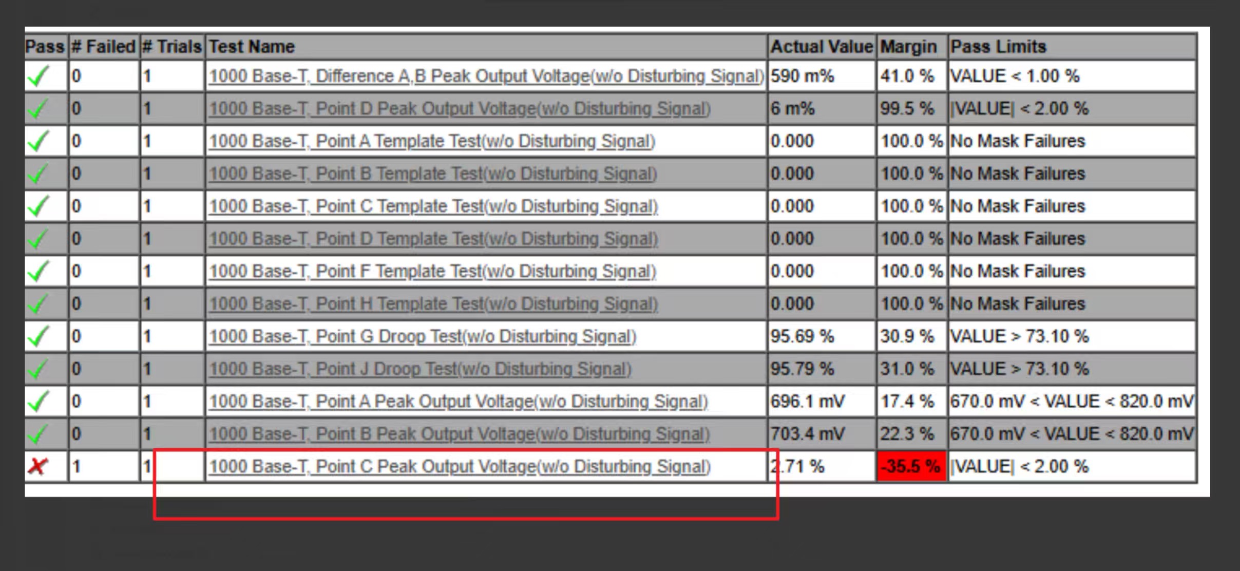

    Please find below issue summary:
    My customer Advantech reported DP83867 failures in MDI Peak Output Voltage testing (1000Base-T).
    Key observations:
    • Customer tested 3 boards, 2 chips each. 3 chips failed and all 3 boards has failed IC —some at U79, some at U82.
    • All the IC has the same marking as below figure.
    • The failed item is Point C or Point D output voltage mismatch. (the test report can be seen in attachment Failed.zip)
    • Swap the failed IC, issue follows DP83867.
    • The 4pcs Intel(I266) PHY on the same board has no issue.
    • Attachment is the layout, sch and test report.
    Support need:
    1. Is this a known device-to-device variation? Could it be related to manufacturing lot, calibration, or specific register settings?
    2. Any further debugging steps to help customer identify the root cause? Please advise on next steps.

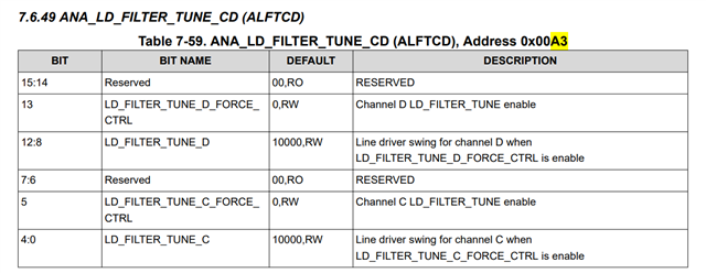

    It appears from the reports you have provided, while peaks a, b, and d are within spec, there seems to be a mismatch on where peak c should be. The 1G spec is really really tight. To help your customer, I do have a register which can help. Can you look to decrease the value of Reg 0xA3[12:8] while setting [13] = '1' from the default position? This can help with peak C performance with the device.
    Sincerely,
    Gerome
  • HI Gerome,
    Can you help to confirm 0xA3[13] and [8:12] is for peak D or peak C?
    BRs,
    Rannie
  • Hi Rannie,
    Gerome is currently out of office.
    However, the bits you mentioned are for channel D. I am not quite caught up with the history here but is the customer failing the peak C for channel D? A2/A3 registers are meant to be tuned for the failing channel. A2 register is for channel A and B and A3 register is for channel C and D. Please advise the customer to tune the register according to Gerome’s suggestion based on the failing channel.

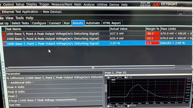

  • Hi J and Gerome,
    Update my customer test results after modifying the register.
    Setting the register of A3[12:8] to 00000 and below is the test results, still not pass, moreover, the point A&B which was passed previously was failed after modifying the register.
    Do you have further debugged method?

  • Hi J,
    The customer has tried tuning register 0xA3[12:8] to both '00000' and '2F' as suggested. Unfortunately, the test results for Point C are still failing. Furthermore, the customer noted a concerning trend: the signal quality becomes worse when the register value is increased. Additionally, modifying this register for Channel C also negatively impacted the previously passing Point A and Point B results.
    BRs,

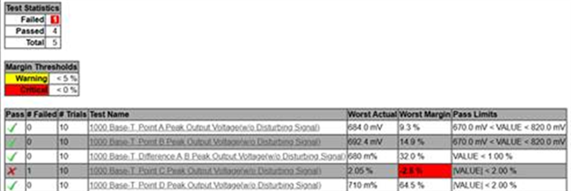

  • Hi Gerome,
    Update the test with new samples. Customer test 2pcs new D/C samples and found the performance was improved. The worst case is 2.05% (2% pass) compared previous 2.71% and 2.38%.
    The support needs:
    1. Whether this issue is known?
    2. Help to identify the D/C that has issues.
    3. Help to provide the root cause. Which electrical performance impact the DP83867 behavior?
