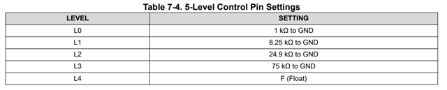

Configuration:
The devices are used in pin-strap mode (1kR pull-down on MODE pin)
  • PD0 and PD1 tied to GND (device enabled)
  • SEL0 and SEL1 tied to GND (controller connected to device 1)
  • EQ and gain set to default values
RX detection:
I tested the following modes:
  • “Outputs polls until 3 consecutive valid detections” with an 8.25 kR pull-down
  • “Tx polls every 150 µs until valid termination is detected” with RX_DET floating
The issue remains the same in both cases.

    Please see my comments:
    1. EQ and gain are strapped as expected.
    2. Since MODE and RX_DET pins are shared between both DS320PR822s, please use resistor values that are half the values listed in table 7-4 (e.g. L0:500Ω to GND, L1: 4.125 KΩ to GND).  Please use 500Ω resistor for R0521 (MODE pin) and 4.125 kΩ resistor for R0522 (RX_DET resistor).

  • Hi Charles,
    I tried the solution you suggested of dividing the values by two because of the two devices on pins MODE and RX_DET, and it's now working as expected.
    LnkSta: Speed 8GT/s (downgraded), Width x4 (downgraded)
    Thanks for your support!
