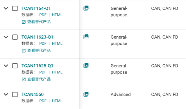

Hi Michael,
Thanks for your prompt reply!
How about TCAN1164? It is cheaper and more suitable for customer application. I would like to know what's the advanced of TCAN4550 mean. Thanks in advance.
BRs,
Francis
Hi Francis,
Would recommend 4550 if the CAN controller is needed. If not, 1164 should be okay as needed by customer's requirement, thanks.
Michael.
Hi Michael,
Thanks, sorry for trouble.
Sorry one more question here, so TCAN1164 will still need to send the data to TXD and cannot only use SPI to transmit data?
BRs,
Francis
Hi Francis,
Yes, the device is not a CAN controller and TXD should still be needed, thanks.
