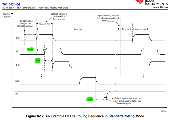

    I think that the polling mode time sequence graph in datasheet is not that clear in terms of when the tComp window is taken:
    In fact, the tComp window taken at IN23 occurs after the polling active time window. It is as if you could set 'when' the comparator window occurs (beginning, end or after polling active time) could it be? or is it always taken, as you already explained, at the last 18us of polling active time?
    Speaking about tComp_typ=18us, could you also share the maximum tComp_max value?
    Thanks for the clarifications.

  • Hello Claus,
    Yes I agree the timing diagram needs to be clearer where the TIC10024-Q1 truly samples the inputs.
    Let me ask our design team this question and the tComp min/max values. Thanks!

  • Hello Claus,
    I was able to confirm the tComp is measured towards the end of the tPoll_Act_Time. See graph below
    However, the team only captured typical data for tComp and not min/max values.
