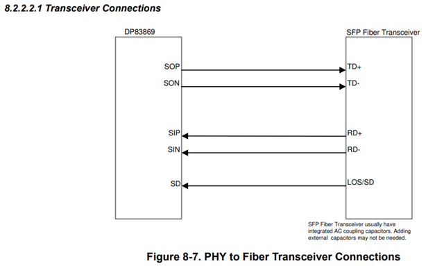

I am using AFBR-59E5APZ fiber connector interfaced with DP83869HM.  with termination of 100E (diff pair) , RD+ and RD-  for TD+ and TD- connected directly to DP83869HM 14th and 15th pins.
Question is : do i need termination for 14th and 15th pins ?

  • Hi Visweswara,
    Here is the connection diagram between DP83869 and a fiber transceiver. I see there are AC coupling capacitors integrated to that transceiver, so you do not need to add these externally:
    You do not need any termination on pins 14/15. The common mode voltage will be set by the PHY.

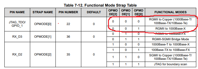

    what is the HW pin strap configuration. since i am using DP83869HM along with copper (1G)
    You are using media converter mode (Copper to fiber) correct? In this case, you should use the following strap configuration:

  • Hi Visweswara,
    So you want options for RGMII to Copper or RGMII to fiber based on resistor population correct? In this case leave an option to pull down JTAG_TDO/GPIO_1 for copper mode. RGMII to 1000Base-X is 1G fiber mode:

  • Hi Visweswara,
    The red circle on Table 7-12 below shows the strap configuration.
    You need to have a pullup on JTAG_TDO/GPIO_1 for fiber mode, and can de-populate this pullup for copper. Since two-level straps are pulled low internally, the PHY will set these to mode '0' by default:
    You would not need strapping on RX_D3 or RX_D2, but you will need a 2.49k pullup on JTAG_TDO/GPIO_1.
