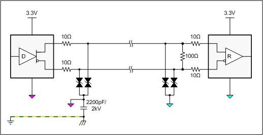

  • Stefano,
    yes you are absolutely correct. You would have to know all of this IF THE INNER STRUCTURE IS GETTING USED or IS IGNITED.
    However, a good protection design assures that the inner structure never gets used. If you are fully RS422 compatible you need to include the +/- 7V common-mode to your input voltage. The maximum combined input specified in RS422 is 10V at which the receiver still has to work. Now this is a requirement for the semiconductor manufacturers, not for you as the end customer. You yourself need to know the maximum possible ground potential difference (GPD) between your driver and receivers. Then you add to this the driver output common-mode. On top of this you would add your maximum Vod/2 of the driver. This total would be your maximum positive line voltage, which should not exceed 10V (as stated above). Now if your driver and receivers have a common ground or little GPD then of course your total line voltage is lower.
    The breakdown voltage of your TVS must be above your maximum expected line voltage to allow for proper data transmission across this voltage range. Then if the line voltage is exceeded your TVS kicks in. Now the clamp voltage of this TVS can be higher than the max 14V of the inputs. And shortly above the 14V the inner ESD cells conduct. These SCRs or mini-thyristors often have a small fall-back current once they latch. I personally suggest trying some 100 ohms to 1k ohms input resistors for protection (after your TVS) to limit the current down to very low values and avoid latch-up of the inner SCRs.
    For the driver on the other side you have a similar procedure but your resistor values should be in the 5 to 10 ohms range for a low-impedance driver output. These resistors whether at the driver or receiver, should have high current / voltage pulse robustness. Typically MELF resistors from Vishay-Beyschlag or often High-voltage resistors are used due to their rectangular design. They usually stay on the PCB while MELF resistor in their cylindrical shape often role of the board. (just a minor issue to think off).
    That's all I know. But I'm an RS-485 person try to protect half-duplex transceivers. So I'm always tied to low-impedance 10-ohms resistors.
    Anyway, I hope this helps a bit.
    regards, Thomas

  • Stefano,
    your Panasonic resistors look like a very good choice. Instead of 100 W use 10 W resistors. I'm also attaching a list of Pulse-load resistors from Vishay (just in case). I 'd say the 50V standoff should do.
    Now the ISOLATED driver came with a surprise to me. So I drew up a grounding scheme for one channel only (which of course applies in both directions). The different ground colours indicate different circuit grounds to which the TVS diodes are connected. I assume that your receiver's circuit ground is directly (DC) connected to chassis and Earth ground. Because your isolated driver's ground is not connected directly to ground you MUST have some an AC path for the fast transients to escape to Earth ground.
    If not, then your TVS might conduct and divert transient currents to the local circuit ground where they are stuck and still cause suffient voltage and electric field strength than can arc to adjacent components and damaging them. (Well this is the theory).  I have not experienced it though, and if possible I don't like to experience never.
    For high voltage capacitors providing this AC path look at the VOVACAP site. They provide a good arsenal portfolio.
    I hope this gets your design going.                           Good luck - Thomas

  • Stefano,
    one more important advise I forgot to emphasize. Place your TVS diodes as close to the bus entrance or connector as possible. The same holds true for the HV-Cap. Transients should never make it into your board but should be diverted to Earth as early as possible.
    So long - Thomas
