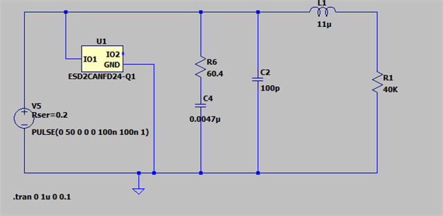

Hi McKenzie,
can you check the model?
Seems to me it is wrong behavior, even cannot dissipate any ESD pulse from 300pF and 2kohm network while I tried Littlefuse ones at same circuit, Littlefuse model works perfectly.
I am not sure if you tried the model before.
Max
Hi Max,
Would you be able to share images of your schematic? I checked out the model beforehand and had no problems, so I can work on replicating yours.

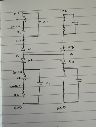

I am a little confused on what you mean by "clamp voltage 47V". For ESD2CANFD24-Q1, the clamp voltage at 16A (TLP) is 36V. The Ipp (max surge current = 2.5A) clamp is 37V. I also don't know what you mean by Figure 16-1 since there is not one in the datasheet.
For the model, it follows the structure below. The RLC values are both device and package parasitics from IBIS models and then the diode parameters.
Is there a specific test standard you are following? This device is rated to IEC 61000-4-2 150pF, 150Ohm and ISO 10605 330pF, 330Ohm. We have not done any validation with 2kOhm.

sorry! it is figure 6-8 on the datasheet,
the problem is that I cannot get below 38V clamp voltage either 150pF, 150ohm, or 330pF 330ohm, it is for Ford, yes we need330pF, 2Kohm, (not working at moment).
it does not even clamp with the schematic i provided early.
it goes to 47V/14.7A with 50v input pulse at LTspice, which does not make sense to me based on the Figure 6-8

Hi Max,
I will send you a new model by end of day tomorrow. I am seeing the same issue you are for 330pF, 2kOhm and seeing higher clamp values on the other ESD ratings.
McKenzie
Hi Max,
I have updated the model slightly. I am seeing a clamp around~38V for 8kV strike at 150pF, 330Ohm. I am also seeing a clamp around ~41V for 8kV strike at 330pF, 330Ohm.
I am not sure why but the 330pF, 2kOhm is still giving me troubles. This isn't as stringent as 330pF, 330Ohm so I don't know why it is not simulating correctly. I can do bench testing on this if it is needed.
I also talked with one of our design engineers about the clamping voltage and we can't fully replicate the snapback of the diode which is why the clamping voltage can be higher than the datasheet.
