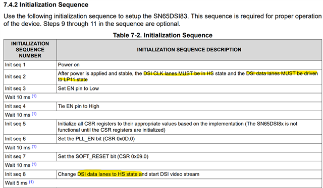

  • Hi Vojtech,
    Since the issue is happening after power-up and initialization, it's likely related to the init. sequence.
    Please make sure that the DSI clock is always in HS state, and data lanes are in LP11 at the start, then changed to HS state as shown in the init sequence. Also note the resets and delays required.
    The REFCLK causing flickering could be related to a mismatch between the pixel clock rates of the DSI not matching the rate of the REFCLK. When setting these, please make sure the REFCLK multiplier, or DSI clock divider are set accordingly to meet the LVDS clock frequency. You can refer to this resolution guide for this: [FAQ] SN65DSI84: SN65DSI83, SN65DSI84, and SN65DSI85 resolution guide

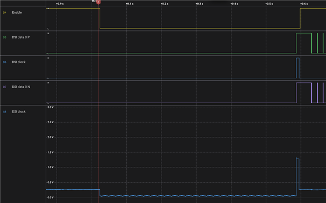

    We have also measured the Enable, DSI clock and one DSI data lane (N + P) during boot that resulted in a flickering screen (which turned black within 5 seconds).
    This looks identicall to boot sequence which results in working display.
    Apart from trying to measure all DSI data lanes at once we are not sure how to progress with this further.
    Vojtech.
  • Hi Vojtech,
    It looks like the DSI clock is not in HS state. There should be continuous clocking on the DSI clock input. Here we only see a pulse before EN is set.
    The DSI clock should be in HS state and data lanes should be in LP state before EN is set.
    An example of the waveforms is shared here: [FAQ] SN65DSI84: No display output with SN65DSI83, SN65DSI84, SN65DSI85
    Ikram
  • Hi Ikram,
    The device used to measure the signals did not display the DSI CLOCK properly, see the following picture captured with another device:
    The DSI CLOCK and DSI DATA are brought to 0 for about 800 ms before the events on the picture, before that the DSI data is in LP11 and DSI DATA is in HS mode. This is different from the picture you shared. However when the enable is brought up the DSI CLOCK and DSI DATA should be in a correct state.
    Vojtech.

  • Hi Vojtech,
    If test pattern with both external reference clock and DSI clock shows no issue, then there is likely an issue either with
    • DSI data lanes: such as SI issue, DSI packet not being in the correct states, or timing mismatch
    • Initialization sequence issue: delays and resets not being set as shown in datasheet
    In the initialization sequence you will notice that DSI data lanes are switched from LP11 to HS state, with DSI stream started AFTER the register initialization and resets. Please check whether this is followed.
