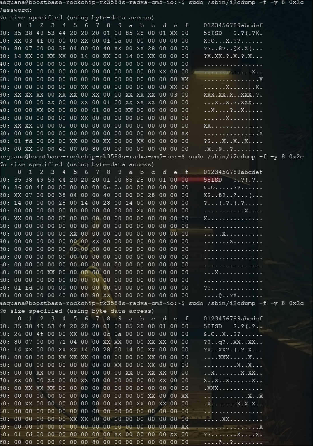

Once the chip is successfully initialized (which in many cases, it happens), then when doing an i2cdump, we get plenty of reads NACKed from the chip (I.e. again, the chip won't ACKed its i2c address - the first byte of the transaction).

In the picture: Example of a i2cdump with many "first byte NACKs" (bytes in XX).

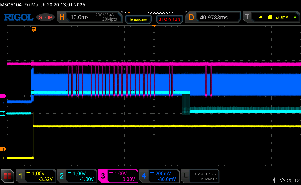

In the picture below: Traces for chip init sequence (1920 x 1080 at 30fps so we can capture clocks).

  • Adding new info:
    We also verify that, when setting up the chip through the I2C write transactions, even when they happen during LP11 of the DSI, we get NACKs for the first byte (I,e, chip not ACKing its I2C address). In the pic, LA with EN in the last channel, then I2C bus with the write transactions. 4 NACKs of 10 transactions.

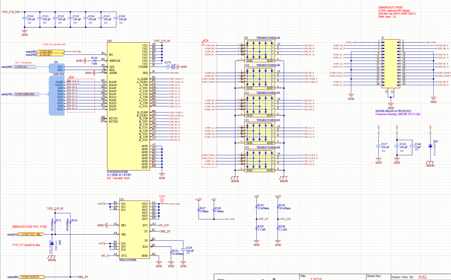

    1. Custom board. Schematics for the bridge, here:

    One other question I have for you, what address are you using when you try to set up a read? I see in your schematic that you are grounding the ADDR pin, so this sets the device in the mode of having an 8-bit I2C address of 0x58 for writes and 0x59 for reads. Are you changing the address between your reads and writes?

    Adding 2 scope captures below, that will answer those questions. The bus is operating at 100kbps, There is a Tr of 1us, and a negligible Tf.
    Data transitions are happening at half way of the clk in 0 state, allowing worst case T_setup of 2us. T_hold is > 4us
    I also did some tests with 2k2 pull ups (I have 4k7 in the board's BOM) and, whilst should give me better Tr and T_setup because of improved T_r (I didn't measure with scope for that case), I get similar statistics of NACKs (i.e 1 every 100 or 200 transactions)
    The very short pulses in SDA in the first trace is the TI chip pulling down the line to ACK the transaction (If the ACK is there, as in, 99%-99.5% of the cases, it's ACKed very fast.
