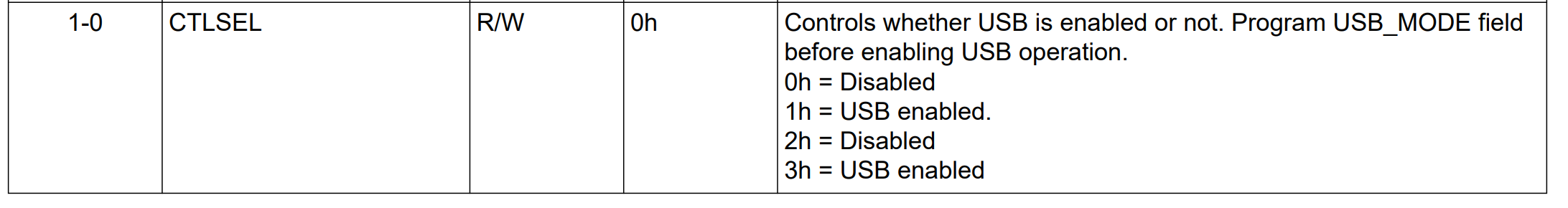

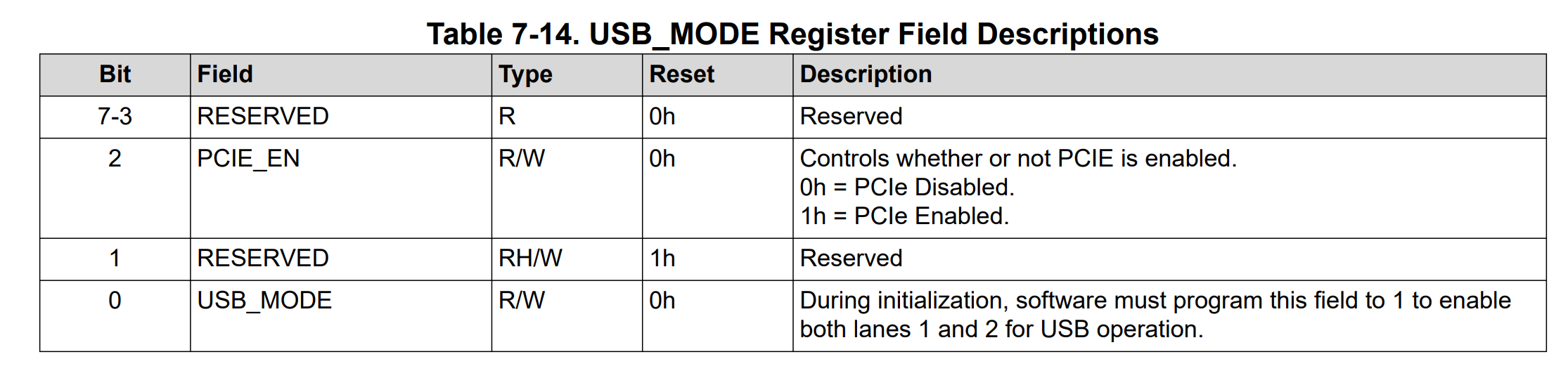

We were expecting TUSB1004 in I2C mode would come up in default state such that it's enabled with certain default EQ settings, and we could adjust various Equalization etc. settings later on if need be for given external cabling setup.
However we have noticed the following in the register map:
  • CTLSEL bits of General_1 register default to 0 which is 'Disabled'image.png
  • USB_MODE bit of USB_MODE register is set to 0 which indicates both USB lanes disabledimage.png
Can TI clarify if the TUSB1004 in I2C mode will be totally disabled at startup such that no USB device detection/enumeration is possible until the above two registers are enabled by I2C writes, or can it detect/enumerate USB devices prior to I2C writes?

    In I2C mode, the TUSB1004 samples the configuration pins upon startup. This is the default state of the part. Afterwards, I2C writes can override this default state.
  • Thank you Vishesh.
    I see none of the configuration pins directly impact the state of USB_MODE (bit 0 of register offset 0xD) or the state of CTLSEL (bits 1-0 of register offset 0xA).
    Thus the TUSB1004 default state in I2C mode has both these bits in their reset state of '0' and both USB lanes are disabled until I2C writes override the default state of those registers like I see is stated is section 7.3.4 below.
