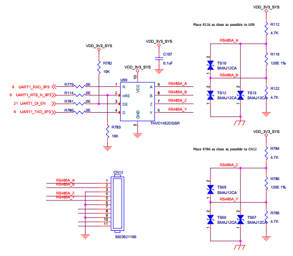

THVD1452: Schematic review - THVD1452DGSR
Part Number: THVD1452
Attached file is schematic of THVD1452.
Please help to review the schmatic for RS485 full-duplex transceiver THVD1452.image.png
  • Hi Vignesh,
    You do not need to add the pullup and pulldown resistors on the RS-485 bus pins. The THVD1452 has them internally.
    I would recommend a pulldown resistor on the DE pin, not a pullup. During power on/off of your system, you don't want accidental transmissions to the bus.
    Ethan
  • Hi Ethan,
    Thanks for the reply. As we plan to use the part "SN65HVD73DGS / SN65HVD76DGS" as an alternate, can we use the same configuration (without pullup and pulldown resistors on the RS-485 bus pins) for the alternate as well?
    We added 120E termination resistors for both transmission and receiver side. Is this fine?
  • Hi Vignesh,
    Those transceivers also have internal biasing. So they don't need the external pullup/pulldowns. However, if you intend to use other transceivers without these resistors, then you can just keep them populated.
    Yes, 2 points of termination are necessary such that the overall bus impedance is 60 Ohms (120+120 in parallel). Your configuration is correct.
    Ethan
