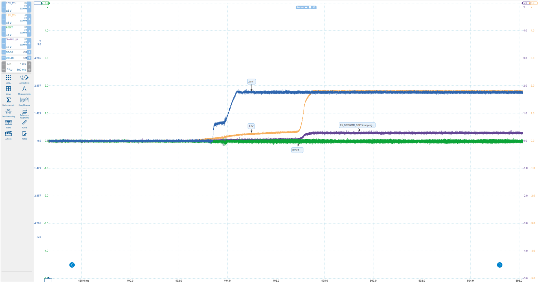

I’m currently troubleshooting an issue during the power-up sequence of the DP83867IR, specifically related to the sampling of the PHY address strapping pins. We are using the PHY in 3-supply mode, with VDDIO at 1.8 V.
We observe two different power-on behaviors:
Working Case
Reset
  • The 1.8 V rail ramps up and settles in ~0.5 ms.
  • The 2.5 V rail begins ramping ~0.1 ms after the 1.8 V rail starts ramping (i.e., before 1.8 V has settled) and settles in ~1.5 ms.
  • Both rails are stable well before reset is released (~200 ms later).
  • In this case, the PHY initializes correctly with the expected address (00001).
  • The RX_D0 strapping pin remains high for ~60 ms after reset release before being pulled low.

  • The power rails ramp in the same order and with similar timing.
  • However, reset is released much later (~2.5 s after both rails are stable).
    (This delay is arbitrary; the same issue occurs for reset delays ≥ ~300 ms.)
  • In this case, the PHY initializes but latches the incorrect address (00000).
  • Notably, RX_D0 is pulled low immediately as reset is released, even before reset reaches 1.8 V.

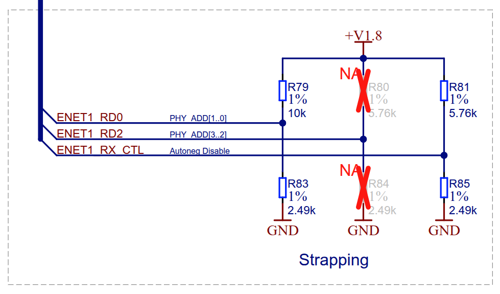

In both cases our strapping looks as follows:
Question:
Do you have any guidance on what could cause RX_D0 to be driven low at reset release in the failing case, resulting in the incorrect strap reading?

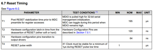

    RX_D0 will apply a 9k pulldown while the PHY latches in the strap setting. This should form the correct resistive divider with your external strap to place the RX_D0 pin in Mode 2 (in your case). Once the strap is latched in, the PHY will pull this pin low with a much stronger termination meant for RGMII signaling.
    It seems from your waveform capture that this happens almost immediately after RESET rises when RESET is delayed >300ms. This would align with the T2 RESET timing in section 6.7 of the datasheet:
    When RESET is not delayed, you get about 60ms of latch-in time before the RX_D0 becomes a transmitter. In this case it appears in the magnitude of the T2 powerup timing for latch in:

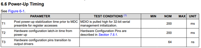

    I wouldn't expect a delay of the reset in-itself to affect the strap latch in value. Let me try and reproduce this on an EVM in our lab and let you know what I see.

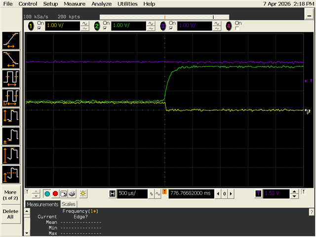

  • Hi Joseph,
    I tested our EVM in the lab and am not able to reproduce this issue so far. I strapped RX_D0 into mode 2 using resistors and am able to read at address 0001. Here is what I saw in the scope when releasing RESET at 600ms:
    Purple (2.5V and VDDIO), Yellow (RX_D0), Green (RESET).
    This seems to follow the waveform in your failing case:
