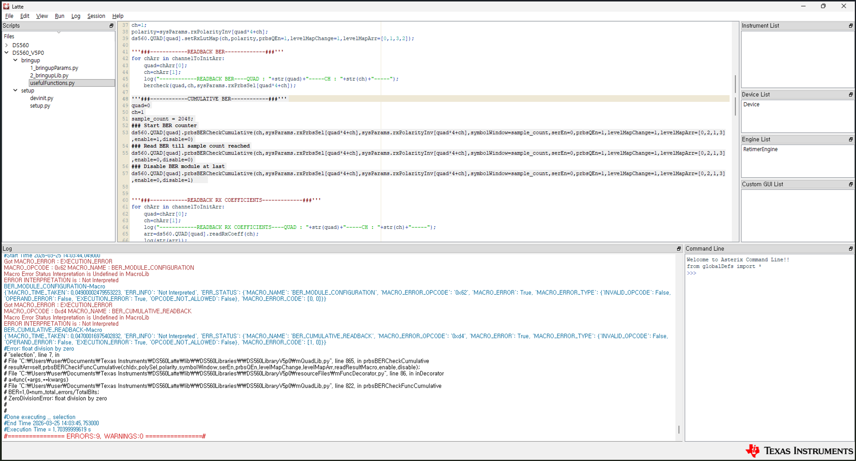

    This is the Log content that occurred after running number 6-5 below.
    #Executing .. selection
    #Start Time 2026-03-25 14:03:44.049000
    Got MACRO_ERROR : EXECUTION_ERROR
    MACRO_OPCODE : 0x62 MACRO_NAME : BER_MODULE_CONFIGURATION
    Macro Error Status Interpretation is Undefined in MacroLib
    ERROR INTERPRETATION is : Not Interpreted
    BER_MODULE_CONFIGURATION-Macro
    {'MACRO_TIME_TAKEN': 0.04900002479553223, 'ERR_INFO': 'Not Interpreted', 'ERR_STATUS': {'MACRO_NAME': 'BER_MODULE_CONFIGURATION', 'MACRO_ERROR_OPCODE': '0x62', 'MACRO_ERROR': True, 'MACRO_ERROR_TYPE': {'INVALID_OPCODE': False, 'OPERAND_ERROR': False, 'EXECUTION_ERROR': True, 'OPCODE_NOT_ALLOWED': False}, 'MACRO_ERROR_CODE': [0, 0]}}
    MACRO_OPCODE : 0xd4 MACRO_NAME : BER_CUMULATIVE_READBACK
    BER_CUMULATIVE_READBACK-Macro
    {'MACRO_TIME_TAKEN': 0.04700016975402832, 'ERR_INFO': 'Not Interpreted', 'ERR_STATUS': {'MACRO_NAME': 'BER_CUMULATIVE_READBACK', 'MACRO_ERROR_OPCODE': '0xd4', 'MACRO_ERROR': True, 'MACRO_ERROR_TYPE': {'INVALID_OPCODE': False, 'OPERAND_ERROR': False, 'EXECUTION_ERROR': True, 'OPCODE_NOT_ALLOWED': False}, 'MACRO_ERROR_CODE': [1, 0]}}
    #Error: float division by zero
    # "selection", line 7, in
    # File "C:\Users\user\Documents\Texas Instruments\DS560Latte\lib\\DS560Libraries\\DS560LibraryV5p0\mQuadLib.py", line 865, in prbsBERCheckCumulative
    # resultArr=self.prbsBERCheckFuncCumulative(chIdx,polySel,polarity,symbolWindow,serEn,prbsQEn,levelMapChange,levelMapArr,readResultMacro,enable,disable);
    # File "C:\Users\user\Documents\Texas Instruments\DS560Latte\lib\\DS560Libraries\\DS560LibraryV5p0\resourceFiles\mFuncDecorator.py", line 86, in inDecorator
    # a=func(*args,**kwargs)
    # File "C:\Users\user\Documents\Texas Instruments\DS560Latte\lib\\DS560Libraries\\DS560LibraryV5p0\mQuadLib.py", line 822, in prbsBERCheckFuncCumulative
    # BER=1.0*num_total_errors/TotalBits;
    # ZeroDivisionError: float division by zero
    #Done executing .. selection
    #End Time 2026-03-25 14:03:45.753000
    #Execution Time = 1.70399999619 s
    #================ ERRORS:9, WARNINGS:0 ================#

    I confirmed that CDR lock for CH1, and I was able to read the BER normally using the "READBACK BER" function.
    Thank you for your help.
    As a added note, "CUMULATIVE BER" function doesn't seem to work. After this function is run, there is a problem that "READBACK BER" function doesn't work anymore. As you said, there seems to be a bug in the "CUMULATIVE BER" function.
