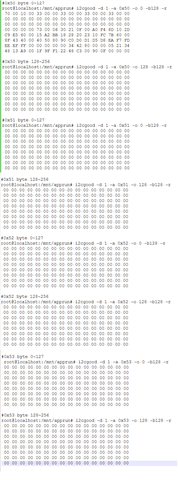

1.You sent a PROFILE for DS250DF210 and upon checking the registers, it was found that the configurations of DS250DF210 and DS250DF230 are not compatible. Could you please send a PROFILE for DS250DF230.
2. I burned an EEPROM and in master mode, the share register 0x11 shows that the eeprom load has been completed, but the read reg value does not correspond to the EEPROM, just like 0x2f.
3. Can you help generate a hex file for DS250DF230 (address 0x4E).
  • Hi Tianyao,
    1. Which configurations are not compatible?
    2. Can you share the EEPROM you burned?  A common issue is that the address map pointer is not pointing to the correct location in the EEPROM.  Please see https://www.ti.com/lit/pdf/snla244
    3. Let's try working with SigCon Architect on this.
    Drew
  • Hi Drew Miller
    Thank you for your reply.
    My HW desgin is single DS250DF230(i2c address 0x4e) connected to single external EEPROM(AT24C08,addres 0xA0),
    and one external SMBus Control(similar to Figure 1 of SNLA228).
    I generated EEPROM HEX file using SigCon Architect(v2.0.0.8),I applied the DS250DF210 profile​ for this
    —could you confirm if this profile is fully compatible with the DS250DF230?
    For your reference, I attach following info:
    1.The SigCon configuration file used:

    3.A screenshot of the EEPROM page settings within SigCon:
    I have verified the contents programmed into the EEPROM by read back via an external SMBus controller after DS250DF230 release i2c bus.
    It appears to match the hex file.
    I have dump some registers status after DS250DF230 resumes slave mode. And  tried share REG 0x4.RST_I2C_MAS,0x4.FRC_EEPROM_RD and disable 0x12.REG_I2C_FAST, but still not work .
    Please refer to following registers dump log for details.

  • Hi Tianyao,
    Thanks for sharing details.  The DS250DF210 EEPROM profile is compatible with DS250DF230.
    There is a bug with the SigCon Architect GUI where it will not correctly populate address map headers when manually entering the address (like you did by entering 0x4E into EEPROM address dialog).  You can increase number of devices, but there is a limit here with reaching 0x4E.
    Do you have flexibility in your design to switch DS250DF230 to address 0x30?
    If not, we can manually update EEPROM image.  I think current EEPROM data may overlap with address map header location for 0x4E, so we will likely need to shift the data and then manually add the address map header in the correct location for 0x4E.
    Drew

    The new issue is that the link cannot link up. The register dump indicates SIGDET OK but CDR LOCK failure (refer to registers 0x01, 0x02, and 0x78).
    As a comparative test, under the same test environment, I performed a hardware rework to set the DS250DF230 to slave mode. Following the 25.78125G Backplane APP configuration from section 5.1 of SNLU182, I configured the DS250DF230 registers via external SMBus Control, and the link successfully linked up.
    The slave mode register dump result is as follows:
    root@localhost:/mnt/apprun/target# i2cgood -d 9 -a 0x18 -o 0xFF -b1 -w 0x00

     02
    root@localhost:/mnt/apprun/target# i2cgood -d 9 -a 0x18 -o 0xA3 -b1 -r
     03
    root@localhost:/mnt/apprun/target# i2cgood -d 9 -a 0x18 -o 0xA4 -b1 -r
     00
    root@localhost:/mnt/apprun/target# i2cgood -d 9 -a 0x18 -o 0xA5 -b1 -r
     20
    root@localhost:/mnt/apprun/target# i2cgood -d 9 -a 0x18 -o 0xA6 -b1 -r
     43
    root@localhost:/mnt/apprun/target# i2cgood -d 9 -a 0x18 -o 0xA7 -b1 -r
     14
    root@localhost:/mnt/apprun/target# i2cgood -d 9 -a 0x18 -o 0xA8 -b1 -r
     00
    root@localhost:/mnt/apprun/target# i2cgood -d 9 -a 0x18 -o 0xA9 -b1 -r
     00
    root@localhost:/mnt/apprun/target# i2cgood -d 9 -a 0x18 -o 0xAC -b1 -r
     54
    Please help analyze the reason why the link cannot link up in master mode.
    tianyao gu
  • Hi Drew,
    Based on the previous SigCon configuration, I attempted to modify several DS250DF230-specific registers (0x40~0x4F), which are mapped to the EEPROM, to their default values as specified in the DS250DF230 Datasheet within the SigCon Low-Level Page.
    The configuration and generated hex file are as follows:

    I have repeated "Step 1 and Step 2" multiple times, and the test results were consistent
    PS:
    a.The reason why do Step 2 is that I compared registers status between slave mode and master mode and found shared register 0x4 is 0x9(default seting) in slave mode.
    b.I have confirmed register 0x4 before  Step2(the original value is 0x1),writing 0x09 should only alter bit 3.
    So that's really confusing to me now. Could you please help clarify the following:
    1.When using a hex file generated from a DS250DF210 profile for the DS250DF230, is it necessary to manually modify the configuration of registers 0x40~0x4F to the DS250DF230 default values?
    2.According to the datasheet, the lower 4 bits of shared register 0x4 are reserved and should not have any effect. Why  is "Step 2" necessary for the link to come up?
    Is there any undocumented special function for bit 3 of shared register 4?
    3.Why is shared register 0x4 read as 0x1 in master mode? According to the Low-Level Page cfg and EEPROM Map, shared register 0x4 supposed to be 0x9.Could there still be an issue with my current hex file?
    I look forward to your reply after you return from your vacation.
    tianyao gu
