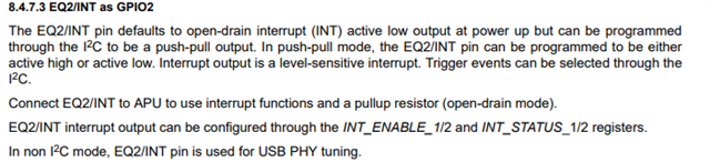

Dear team,
My custmomer want to use the TUSB2E221 I2C function,  However, they want to leave EQ2/INT pin as flotaing.  from Hardware, it should be okay as this pin is OD, but customer want to know funtionly, when will this INT be used?
Thank you
