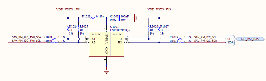

Part Number: LSF0002
Hi experts,
Would you please help review schematic of LSF0002?
BR,
Allan
The total pull-up current on each I²C line is about 5 mA, which is more than the default limit of 3 mA in the I²C specification, and which is probably more than the drive strength of the 1.8 V device. I recommend to make all pull-ups at least 2.2 kΩ.
