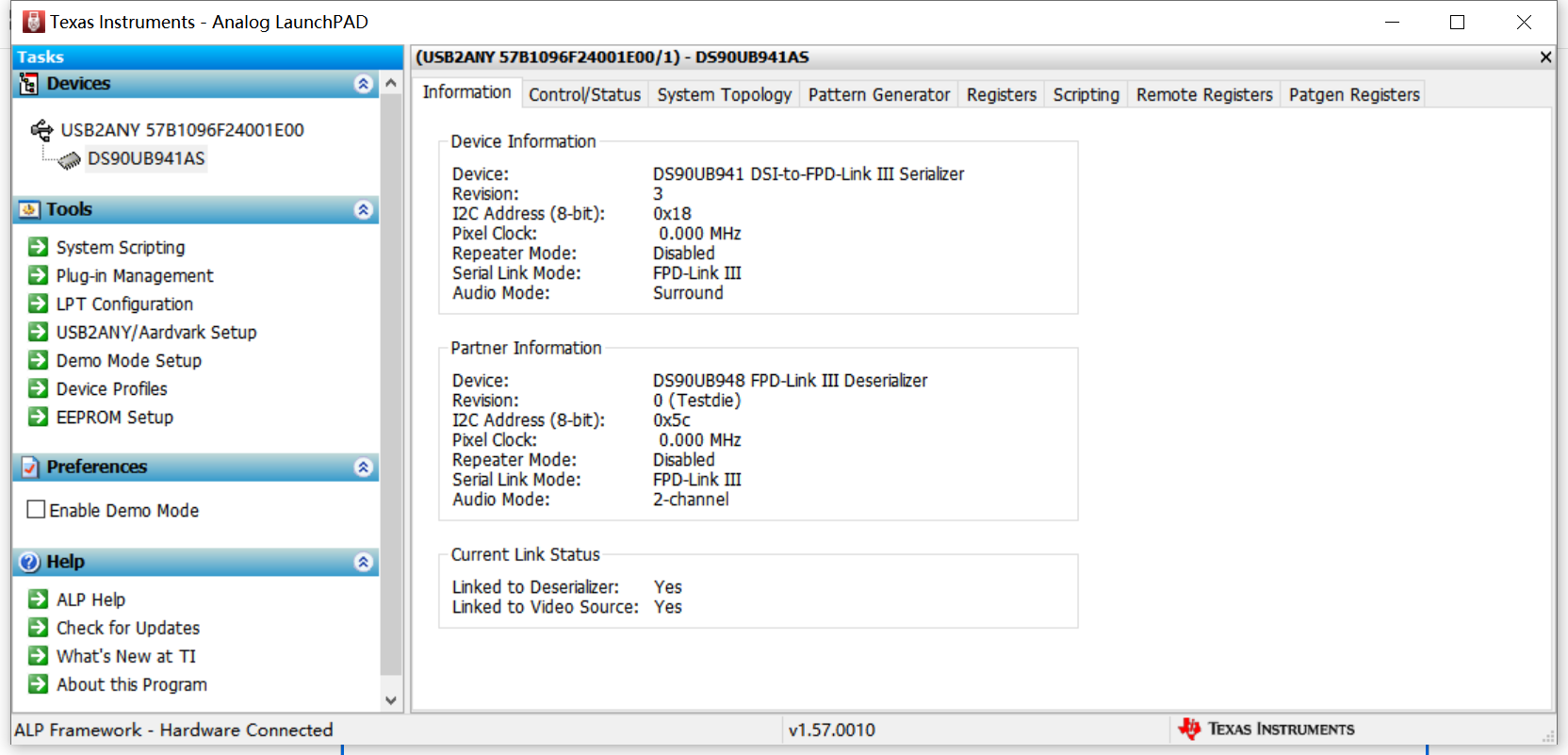

Hello Li,
If you are referring to Margin Analysis Program (MAP), please refer to the following application note for more details: https://www.ti.com/lit/ug/snlu243/snlu243.pdf
The MAP tab can be found in the deserializer's ALP profile.
Nikolas

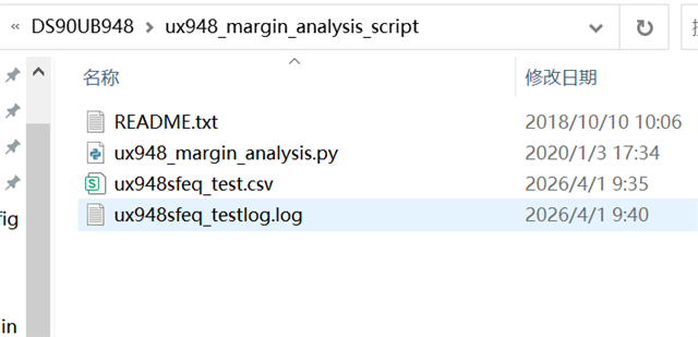

Is it not possible to perform margin testing on the 941? I noticed that the document you shared does not mention anything related to it. Are there any alternative methods to conduct margin testing? I am using a 941 EVM along with a self-developed 948 screen.
Hi Li,
MAP can only be measured from the downstream deserializer device. However, measuring margin from the deserializer will monitor link health across the FPD-Link (i.e. between SER and DES), so this should be sufficient for your needs.
Nikolas
Hi Li,
Where did you locate this script from? If you could provide me with the .py file, I can take a closer look and confirm for you.
