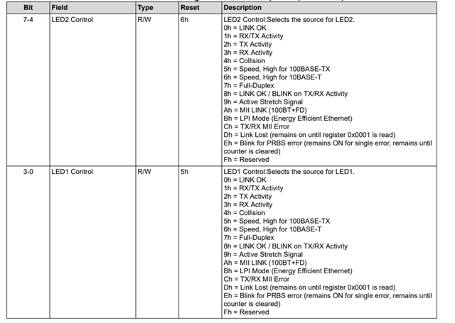

  • Hi David
    A first fast test validate what you are saying.
    But Im a littel bit confused because the datasheet says:
    This Pin is a 10 MBit signal by default and i read back a value of 0x6 in this register (LEDCFR).
    But her is described something other:
    Kind Regards
    Thomas Donner
  • Thomas
    This is a typo in the LEDCFG register (0x460) which we will correct in the next revision of our datasheet.
    Bit [3:0] are the LED1 control as shown below.
    David
