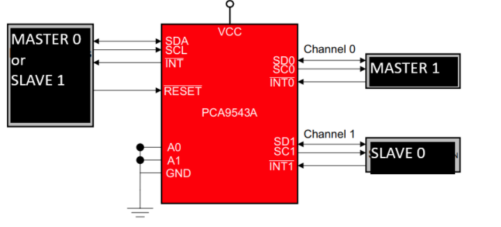

Part Number: PCA9543A
My application is as follows:
I wanted to confirm that SCL propagates through the IC in both directions, i.e., can a master on SC0/SD0 communicate with a slave on SC1/SD1 and a slave on SDA/SCL?
Hi Gerassimos,
This MUX is passive so I believe it will be able to accomplish what you are suggesting as long as the device is being used within the recommended specification.
Thank you,
Arya
