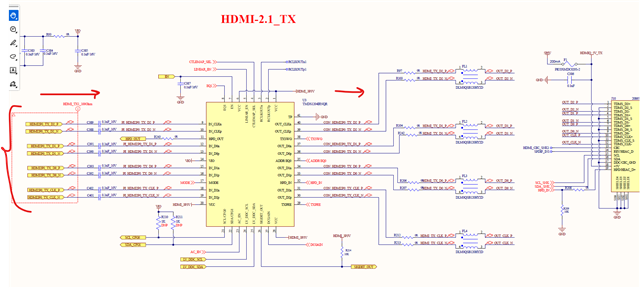

I am currently working on a hardware design involving an HDMI 2.0 transmitter and would greatly appreciate your expert review and guidance on my schematic. The design is intended to support high-speed video transmission compliant with HDMI 2.0 specifications, and I want to ensure robustness, signal integrity, and compliance with TI’s recommended design practices.
Project Overview:
  • Application: HDMI 2.0 Transmitter (TX)
  • Target Resolution: Up to 4K @ 30Hz
  • FPGA/Controller: PolarFire FPGA
  • HDMI TX Device: TMDS1204
  • Power Supply Rails: 3.3V
Request for Review:
I kindly request your support in reviewing the following aspects of my schematic:
  1. Power Supply Design
  2. High-Speed Signal Routing
  3. ESD and Protection
  4. DDC / HPD / Control Signals
I have attached the schematic PDF along with relevant design notes for your review.
SCHEMATIC_HDMI-2.1_TX.PDF
Please let me know if any additional information is required from my side. Your feedback will be extremely valuable in helping me finalize a reliable and high-performance design.
Thank you very much for your time and support.
Milan
  • Hi Milan,
    Below are my comments:

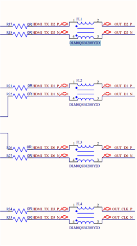

    1. Please co-lay 0 ohm resistors and common mode choke in the layout:
    2. The CMC cut off frequency is too low (2GHz). We recommend the cut off frequency to be three times the Nyquist frequency of the data lane so 9 GHz.
    3. ESD diodes used for HDMI may have too high clamping voltage (8.8V) for our device to survive ESD events. Please refer to ESD diodes like PUSB3FR4Z for lower clamping voltage ESD diodes.
    J

  • Hi Milan,
    Point 1 is for layout. We typically recommend customers to co-lay the pads for CMC and the 0 ohm resistors in the layout so they can replace the CMC with a 0 ohm resistor if needed. This is because CMC may impact HDMI's signal integrity.
    Point 2 is not for schematic change, but for BOM change. The CMC used in this schematic has a low cutoff frequency and we recommend customers to use CMCs with higher cutoff frequency (9GHz for HDMI 2.0).
    Otherwise, the schematic itself looks good (except for point 3).
    J
    Point 1 For now we have released our design for the prototype. So that opinion will not be able to be added.
    Point 2/3 We have used a CMC & ESD diode in the eval board schematic (SLLU341).
    So for prototype purposes, is that okay to go & do you really think that it will work for 12G as per my schematic design?
    Milan
  • Hi Milan,
    CMC and ESD diodes both should be fine. It is more of a recommendation for our customers based on our past experiences. I do not anticipate any functional issue.
    J

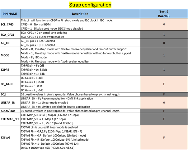

    We are currently using strap mode—do you think this could be causing any issues?what we have missed?
    Also, we are operating at a 6G data rate. Based on this configuration, do you see any potential concerns?
    Additionally, we are planning to switch to I2C mode. Could you please provide the list of registers that need to be configured?
    Milan

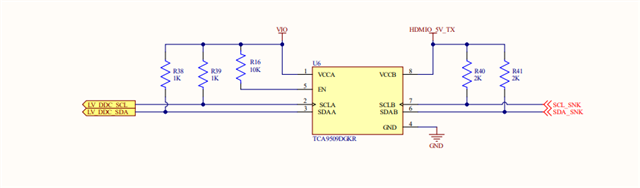

    The DDC bus uses the I2C protocol. When a monitor plugged into the HDMI receptacle, the source uses the DDC bus to read monitor vendor/model ID, resolution supported, etc. The source also uses the DDC to communicate to the monitor when switching between HDMI1.4 and HDMI2.0. The TMDS1204 uses its LV_DDC_SDA/SCL to snoop this bus and configure itself automatically between the HDMI1.4 and 2.0. You can use an I2C decoder or analyzer to read the DDC communication. When I am looking at the schematic, I noticed that you have pullup on LV_DDC_SDA/SCL as shown below. Please remove R38 and R39 since TMDS1204 has internal pullup.
    The TMDS1204 as a re-driver has no concept of resolution, so when you say "We are currently receiving HDMI video at a resolution of 1922x1080p @ 59 Hz, while the input provided is 1920x1080p @ 60 Hz.This behavior is observed when the IC is configured in strap mode, and due to this mismatch, the output is not detected on all monitors", what does this mean?
    The design itself is DC-coupled to the HDMI receptacle. But AC_EN pin is being pulled high for AC coupled output. You would need to pull it low for DC coupled output.
    For I2C mode, you would leave MODE pin floating. But before we switch to the I2C mode, can we stay in the pin strap mode and make modification to the DDC and AC_EN pin first?

    You suggested making two hardware changes:
    1. Remove the LV I²C pull-up resistors.
      Note: We are not currently doing anything on the DDC I²C lines—just connecting them directly to the source.
    2. Set the AC_EN pin to low.
    Will these changes resolve the issue?
    If the problem still persists, what should be the next steps in I²C mode? Please suggest the that options with required setting.

    I will test all options in strap mode, which you have suggested, and see what happens.
    In I²C mode, we are unable to perform write and read operations. Using Aardvark, we are trying to read the ID, but nothing happens.
    Could you please suggest if any hardware configuration is missing or if something needs to be adjusted for I²C?
    We are so close, just something missing...!!

    With 20k pulldown on ADDR, this will set the address to 0x5D. And with MODE pin floating, then this will enable TMDS1204 in the I2C mode.
    Can you populate R31 and R32 with 4.7k and disable the I2C pullup in the Aardvark controller?
    You can also replace R52 with 1k and try with I2C address of 0x5E, does it work?

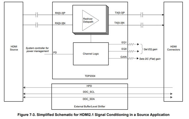

    Below is a high level block diagram of the DDC bus.
    The source (FPGA) and monitor exchanges information with each other across the DDC bus using the I2C protocol. Its primary purpose is to allow the monitor to communicate its capabilities—such as resolution, refresh rate, and color format—using EDID (Extended Display Identification Data). Besides the EDID, there is the SCDC register address offset 0x20 for TMDS configurations between HDMI1.4 and HDMI2.0.
    • Bit 1: TMDS_Bit_Clock_Ratio
      • 0 -> HDMI1.4
      • 1 -> HDMI2.0
    • Bit 0: Scrambling_Enable
      • 1 -> HDMI2.0
    For more detail on the DDC bus, you can see this video, https://www.youtube.com/watch?v=FpLH4rePvjc
    So if you try to support different resolution with different monitor, then you nee to have the ability of the FPGA to read the monitor EDID, and communicate to the monitor when switching between HDMI1.4 and 2.0.
    To verifying this function, you can use an I2C analyzer.

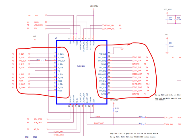

    Additionally, we noticed that in your EVM, all lane connections are swapped, including the P and N lines. Could you clarify why this is required?
    Any additional documents needed to study for that swapping on pins?
    Thank you.
    The EVM was designed to accommodate both TDP1204 and TMDS1204. If you compare the pinout between the two, the lane order are swapped between the two. With the EVM design followed the TDP1204 pinout, when comes to TMDS1204, we basically use its SWAP function as shown below.
    How did you get 6G to work in pin strap and I2C mode? For 8G, 10G, and 12G, I assume these are HDMI FRL. If you read TMDS1204 register 0x31, do you see the FRL_RATE being set correctly?
    David
  • Hi David,
    The issue was due to a pinout mistake on our side—we had made an incorrect connection, as seen in the previously shared schematic.
    We used the swap function to achieve the required pinout as per the reference schematic. Please see attached image for the final connection planned for the next board revision. Could you please confirm if this looks correct?
    With this updated connection, will we still need to use the swap function, or will a direct (straight) connection work?
    Additionally, in the reference schematic, the P and N polarity appear to be swapped. Can you confirm if this is acceptable?

  • Milan
    The TMDS1204 is backward compatible to HDMI1.4b and HDMI2.0b.
    Since it is a re-driver, you can swap the polarity as long as the polarity matches between the input and the output.
    The TMDS1204 implements a fan-out buffer feature to support applications which the HDMI clock and data on separate paths, and typically this is on a RX design with a FGPA. But in your case which is a HDMI2.1 TX design, why do you use TMDS1204, and not TDP1204? I would also recommend TDP2004 for a AC coupled source side design as its data rate of 24Gbps gives you more margin than TMDS1204.
    David

    TMDS1204 can support higher data rate above 6G. But if you not planning to use its fan out buffer feature, why not use TDP1204? For your TX side design, I would think TDP1204 be a more appropriate choice.
    Instead TMDS1204 or TDP1204, you can also use TDP2004 if you want more margin.

  • Hi David,
    I was reviewing the TI document TDP1204 (“TDP1204, TMDS1204 Migration from HDMI2.0 to HDMI2.1”), and it mentions that HDMI 2.0 supports only 8-bit color, while we are targeting 10-bit or 12-bit color. Based on this, does it mean we need to use HDMI 2.1?
    Thanks.

    So in my case we have not getting 1080p60hz 10bit with the same hardware.
    Could you please let me know what exactly we missed?
