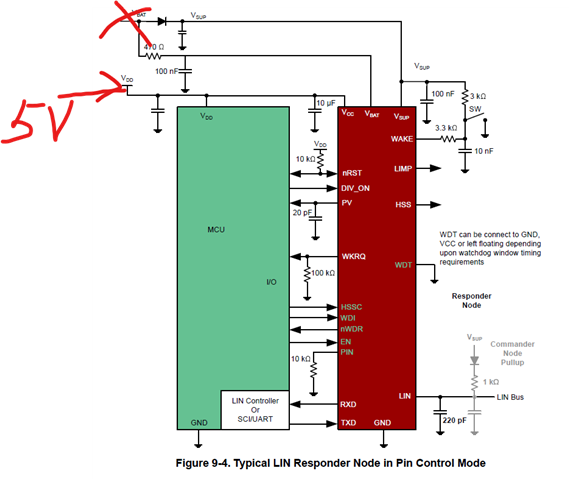

  • Hi Michael,
    For now, my customer add a 0 ohm on the reset pin of TLIN1431. And they remove it when they need to debug, so that even the reset pin is pulled down by TLIN1431, the MCU would not be reset by TLIN.
    One more question: They need to flash firmware to the MCU when in SOP. At that time, the MCU also could not service the watchdog. Now they want to just disable the VBAT and just add an external 5V on VCC. They worry that this 5V may destroy the TLIN. Please check if the Vcc pin can support 5V for TLIN14315-Q1.
    Besides, could you add the watchdog disable feature in new TLIN SBC devices?
    Peter
  • Hi Peter,
    I presume customer is asking about Pin mode. If not the case, please help confirm and I could inform the team if feasible for future devices.
    For SPI mode, this is an option as shown below. Also, 5 V should not damage as long as the abs max is not violated, thanks.
