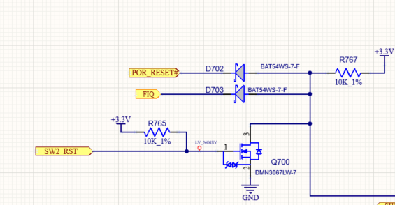

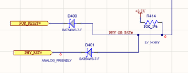

  • PHY reset:
  • MAC Reset: Stays in Reset until software is ready
  • Hi Walter,
    I apologize for the delay in response.
    Reset circuitry does not seem to have any issue. When there is no pullup on TXD_1, what is the voltage of TXD1?
