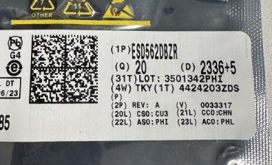

When ordering ESD204DQAR, it isn't possible to determine which package is being used. Once you receive parts, you should be able to tell based on the shipping information labeled on the devices. If 'ASO' lists 'CDA' then it will be the DQA0010B package.
