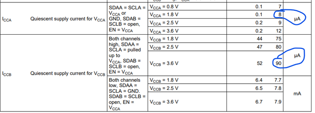

Can you please share the power dissipation value for this part

    We are using VCCA as 1.8V logic and VCCB  as 3.3V logic for this buffer. On the A side we are using the Pull up resistors of 4.7K ohm.
    What is the worst case for considering the power dissipation of this part TCA9803? Kindly update us

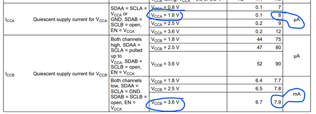

    The worst case power consumption is when SDAA = SCLA = low. There will be some power consumption by your open-drain driver (from target or MCU) that will sink the current from the pull-up resistors on A-side. This however does not factor into the power consumption of the buffer.
    I assume there are no pull-up resistors on B-side of the buffer, as this is the proper use of the buffer relying only on the internal current source which has a typical current of 3.3 mA pull-up current for TCA9803.
    A majority of the current will be through ICCB supply. There is some current from ICCA.
    Ptotal = (ICCA)(1.8V) + (ICCB)(3.3V) = ~(7.9mA)(3.3V) = 26.07 mW.
    This is the DC state if A-side is held low. In practice, I2C will run a logic low only for short periods of time (microseconds of time) for each I2C transaction. You will dissipate more power overtime the more times that the device drives a low.
    In the Idle state when both sides are high, the quiescent supply current drops. You can expect much less power dissipation:
    Ptotal(idle) = (1.8V x 8uA) + (3.3V x 90 uA) = 0.0144 mW + 0.297 mW = 0.3114 mW
