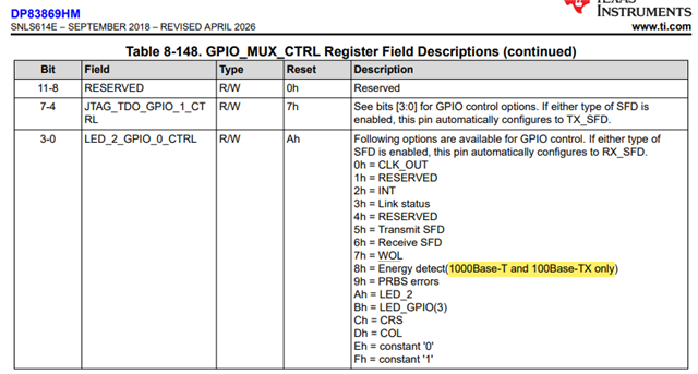

  • Hi Uchikoshi-san,
    As an update, I did test out the energy detect feature with long cabling (~ >130m to push limits on cable reach, since shorter cabling is nearly guarantee to link in my lab). I did see energy detect LED go high prior to linkup in conditions where linkup was intermittent due to longer cabling, so I do think this is promising. However, setting nearly 180m of cabling caused no link up and no LEDs (even the Energy Detect LED).
    I think this option could be viable for your customer's application so long as they validate it with their use cases. This is not a mechanical detection of the cable to the RJ-45, so there could be cases where the cable is completely plugged in, but due to severe attenuation, even the LED would not light up.
    Please also let me know customer response to 3s wait time as alternative approach.
    Sincerely,
    Gerome

  • Hi Gerome,
    Before closing this inquiry, please let me confirm below.
    1. The Energy detect should not reply on the speed but we are not sure why the datasheet says that the energy detect is supported only for 100M and 1000M
    2. The energy detection cannot be checked by the status register. Only GPIO is supported.
    Uchikoshi
  • Hi Uchikoshi-san,
    Both of these points are correct.
    Sincerely,
    Gerome
