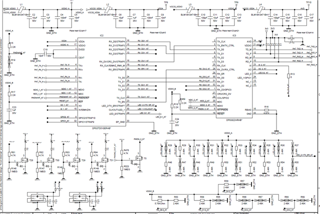

We are using a reference design from Texas Instruments for an Ethernet-to-SPE converter. In this design, a 25 MHz external crystal oscillator (ABM8AIG-25.000MHZ-12-2Z-T3) is used, which has a worst-case temperature stability of ±70 ppm.
This 25 MHz clock is provided as an input to the SPE PHY (DP83TD510ERHBR). The SPE PHY uses its internal PLL to generate a 50 MHz reference clock required for the RMII interface and outputs this clock to the Ethernet PHY (DP83822HRHBT).
Since the system supports bidirectional communication (Ethernet ↔ SPE) over RMII, the 50 MHz clock is critical for timing synchronization between the two PHYs.
The objective is to verify whether this TI reference design will operate reliably over the temperature range of –40 °C to +85 °C, and to evaluate whether temperature-induced variations (such as oscillator stability and PLL behavior) could impact the timing relationship between the two PHY devices.

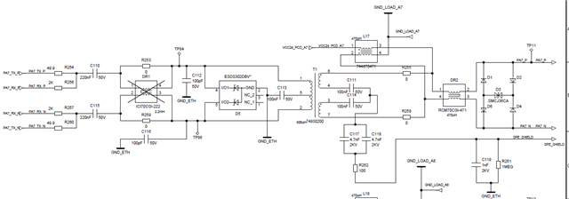

  • We have completed EFT immunity testing on the EUT and monitored Ethernet-to-SPE communication performance during the test.
    Observed Results:
    • 500 V EFT: Communication stable with 0% packet loss
    • 1 kV EFT: Communication active, but 4–5% packet loss observed
    • 2 kV EFT: Communication failure
    Current Status:
    The design performs acceptably at lower EFT levels, but fails to meet robustness requirements at 2 kV. To ensure compliance and achieve stable communication with minimal or zero packet loss across all required EFT levels, especially at 2 kV, further hardware optimization is necessary.
    Target Objective:
    Achieve:
    • 0% packet loss at 500 V
    • 0% packet loss at 1 kV
    • 0% packet and Stable communication without failure at 2 kV
    Please review the schematic and suggest required hardware modifications, layout updates, and protection enhancements to improve system immunity and ensure compliance with EFT requirements.
    1st Schematic: Ethernet to SPE communication using 2 Phys.
    2nd Schematic: CDN Network (Coupling Decoupling Networking)
    Flow is from Ethernet Phy to SPE Phy then through CDN Network and then next to relay
  • Shreyas,
    There are a few points that may help in getting better EFT immunity test results. I assume you are referring to the IEC 61000 4-4 EFT test, in which the high frequency pulses are sent to the ethernet cable through capacitive clamping.
    One of the biggest gaps in this test is using shielded cables, are you using shielded cables for these tests? The high frequency bursts can usually find a path through the shield to the connector ground, which should help in EFT immunity.
    If shielded cable are used for EFT testing, the main concern is the low impedance path between the connector ground to earth ground. Similar to ESD testing, a good ground path can reduce the potential ground bounce and reduce the common mode voltage injected into the system.
    It seems like there is no ground isolation being used. This is highly recommended for better performance to reduce ground bounce in the system. Additionally, a ground layer below the MDI lines in the layout can help in better impedance matching, if not already present.
    This Application Note also covers this test and some details about the setup. It seems like this result is matching your requirement. The reference design board used for these tests is the TIDA-010261, which can be found here for schematic/layout reference.
