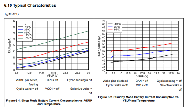

Can you pls help check if there are any data or plots showing power consumption / effeciency changes with temperature for the TCAN2411-Q1 product?
For example, current consumption changes during CAN communication according to temperature.
