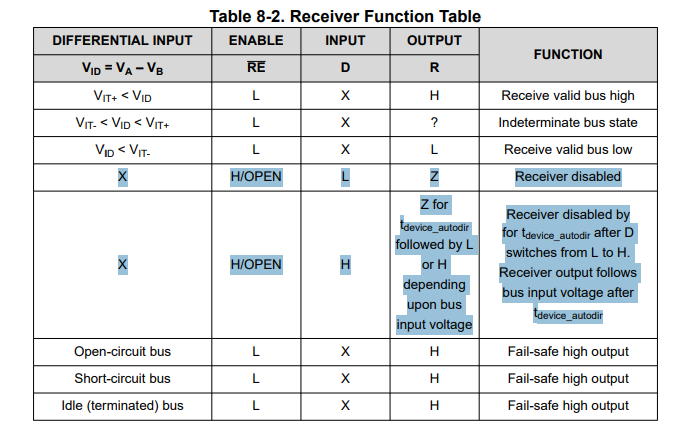

Now they don't have enough GPIO to control REn so they plan to use auto-direct function.
Datasheet said user needs to connect both REn and SDn to high and when D's status changes, Receive will work even REn is high.
But when D is from L to H, THVD1426 will keep Z for 8us and then receive signal from BUS.
Customer don't want to receive signals what they send by D.
How about customer send continue high high high signal by D.
    This is incorrect. 8us is for the THVD1406 which has a data rate of 500Kbps max. The THVD1426 time is 0.8us since it is supposed to be used with data rates at ~12 Mbps.
    This is not possible to change. The receiver will stay enabled while the driver is transmitting. We do not have another transceiver that accomplishes this.
    If the D input is high for greater than t_device-auto-dir, then the driver will be high-impedance. Again, this is not changeable due to the nature of the auto-direction feature. Otherwise, the transceiver would not know when to switch modes.
