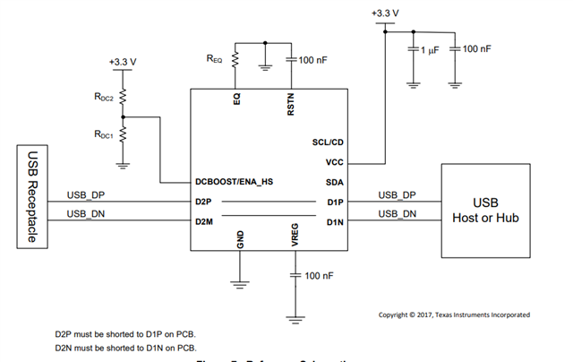

I would like to check with you does TUSB212 support pin1 and pin8 connect to USB DP, while PIN2 and PIN7 connect to USB DM?

Thank you Ryan,
The standard connect:
D1P --- USB_DP, D1M --- USB_DM;
D2P --- USB_DP, D2M --- USB_DM.
Can device support swap together like below connect?
D2P --- USB_DP, D2M --- USB_DM;
D1P --- USB_DP, D1M --- USB_DM?
Hi Kailun,
The TUSB212 must be connected like below:
D1P must be shorted to D2P beneath the redriver, and D1M must be shorted to D2M beneath the redriver. The redriver works bidirectionally, so as long as DP/DM are shorted together it should be okay.
