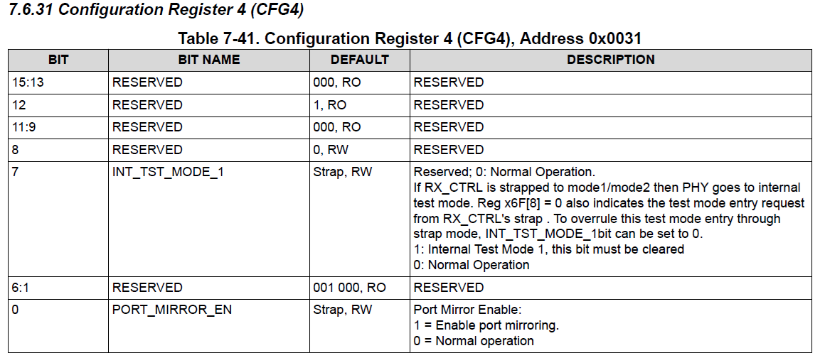

I have set the STRAP configuration for the RX_CTL pin of the DP83876IR to Mode 1.
In Note (2) of Table 7-5 in the datasheet, the description of bit [7] in “Configuration Register 4” includes the term “internal test mode.”
Q1: Could you please explain what “internal test mode” is?
Q2: Is 1000Base-T communication possible even if bit [7] of “Configuration Register 4” remains set to 1?
Q3: If bit [7] of “Configuration Register 4” is not set to 0, what kind of problems might occur?

    1. We cannot disclose what internal test mode does.
    2. Yes the PHY can function normally even when it is in internal test mode. It will do 1G communication without any issue.
    3. You can set it to 0 but as this is not the only bit that outs the PHY in the internal test mode. Register 0x6F[8] also indicates if the PHY is in test mode so if that bit is not set, there is no need to clear this bit to 0.

    According to the datasheet, since 0x6F[8] has a default value of 0 and is read-only (RO), it seems that the only way to disable internal test mode is to set 0x31[7] to 0. Is this understanding correct?
    Is there another method, such as setting 0x6F[8] to 1?
    Yes, this is correct.
    This is not possible.
    However, please note that writing 0 to 0x31[7] is only necessary when 0x6F[8] is set to 0. The datasheet specifies that the default value for this bit is 0 but this is not entirely true since the reset value depends on the strap pin. If RX_CTL pin is strapped to mode 1 or 2, 0x6F[8] may set to 0. Otherwise, this bit should set to 1 by default.
