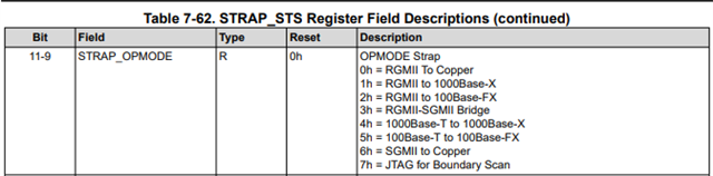

    The behavior you described suggests the buffer is interfering with the strap latch-in of OPMODE[0]. The most direct way to check this is by measuring the voltage value of the JTAG_TDO pin to see if it is expected.
    Another check you can perform is to read the strap latch-in register (0x006E[11:9]). What value do you see in this register in both the working and non-working cases?
    the switching between 100M/1G mode is happening without any power cycle (switching we are doing via the SW3 Pin 1 &8)
    You are switching speeds without any power cycle or reset of the PHY? If you are changing strap modes, you should need a reset to re-read the straps.
