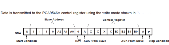

I am a new user of TI chips. I was using the PCA9546A IIC Multiplexer chip to multiplex data on the FMC DVI Card connected to an FPGA board.
From the diagram shown above(from data sheet) - it shows that a stop condition has to be invoked once the control register is written to.
To write data to the slave device, should I invoke a stop condition after writing the data ? Or is there some other way to transfer data after I have written to the control registers ?
