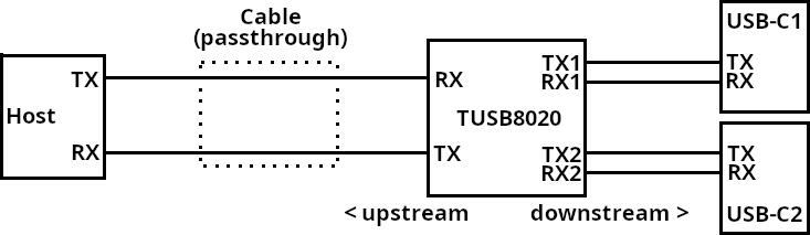

TUSB8020B: USB SS TX/RX swapping
Part Number: TUSB8020B
Regarding USB SS RX/TX crossover, does the TUSB8020B act like a mux and map upstream RX to downstream RX, or does it map RX to TX?
My design uses a custom cable that does not swap RX/TX. How should I cross them on-board in my design? Is the below scheme correct?
