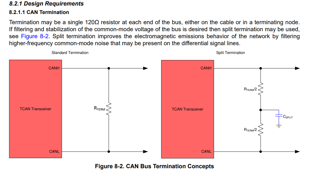

Customer is evaluating TCAN1472-Q1 in their project and there are following questions:
  1. For CAN termination, any recommendation for C_split use in differential mode noise?  image.png
2. For common mode noise, we used the formular c=1/(2*pi*f*r) with data rate 5Mbps, caculated capacitance is out of 4.7nF, how should we choose the C_split? Any recommendation capacitance if we need 5Mbps?
3. Can we add split termination circuit on both end of cable and termination node? Any risks for this?
BRs.

  • Hi Frank,
    1. and 2. Yes, 4.7 nF is typical for typical speed. However, for higher speed, 1 nF to 4.7 nF could suffice (calculated 1/[2*pi*2.5MHz*120ohms] as 0.53 nF) where 4.7 nF considered with the high speed if you have stronger EMC issues and the signal integrity is still acceptable.
    3. Yes, this is actually recommended, thanks.
    Michael.
