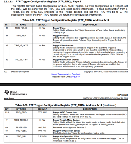

I want to output PPS from GPIO4 of the DP83640.
Upon reviewing the DP83640 datasheet, I found the statement, "The DP83640 can be programmed to output a Pulse-Per-Second (PPS) signal using the trigger functions," but it did not provide specific configuration instructions.
I would like to know the detailed setup procedure, including which registers to write which values ​​to.

  • Thank you for your reply.
    I am using the DP83640T-EVK/NOPB-ND evaluation board.
    I set PTP_TRIG as follows, but I cannot output PPS.
    ・TRIG_PULSE 1
    ・TRIG_PER 1
    ・TRIG_IF_LATE 1
    ・TRIG_GPIO 4
    ・TRIG_WR 1
    Is it unnecessary to set PTP_TDR or PTP_CTL?
    The following site seems to set them: github.com/.../dp83640.c
  • Hi Takahashi-san,
    You are correct. You also need to enable and load trigger using PTP_CTL register and then set PTP_TDR register after loading the trigger. I think these registers and setting the trigger GPIO pin on PTP_TRIG should output pps pulse.
