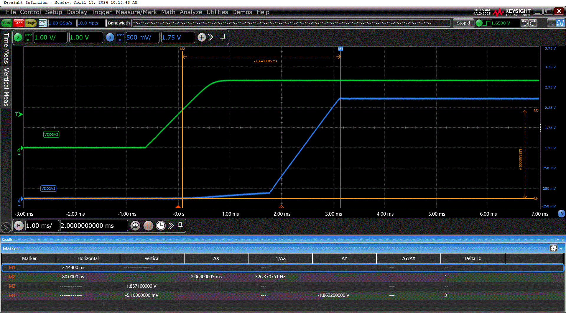

Hi expert,
Is there a possibility that current could leak from VDD3V3 to VDD2V5 inside the LMH0070 when the power is turned on?
As described on Datasheet Page 9, the power is applied in the order of 3.3V first, then 2.5V, but it appears that the 2.5V voltage is rising while the 3.3V power supply is still being ramp up.
*The attached waveform was captured under the conditions of modifying the board so that only the LMH0070 is supplied with 3.3V and 2.5V power.
