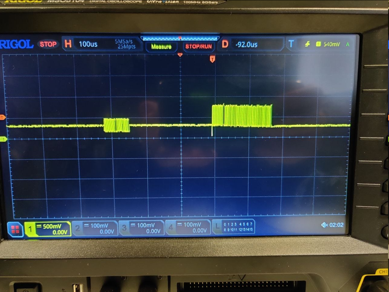

Problem summary
I could not get display output when using the SN65DSI86 through the Linux driver, so I decided to first verify the bridge independently of the driver by using the internal color bar test pattern.
A color bar test script was shared in the forum. I verified that script on the TI J722S EVM, and the color bar appears correctly on the monitor there.
After that, I repeated similar steps on our custom board, initially without using the Linux driver.
What I observed
  1. The SN65DSI86 appears on the expected I2C bus addresses.
  2. The device registers are readable over I2C.
  3. HPD behavior correct. I monitored register 0x5C while unplugging and plugging the DP cable.
  4. We also measured the HPD voltage, and it is about 1.6 V when the DP cable is plugged in.
  5. However, when I run the same verified color bar test script on our custom board, I do not get any image on the monitor.
  6. I also dumped the SN65DSI86 registers after running the color bar test script.

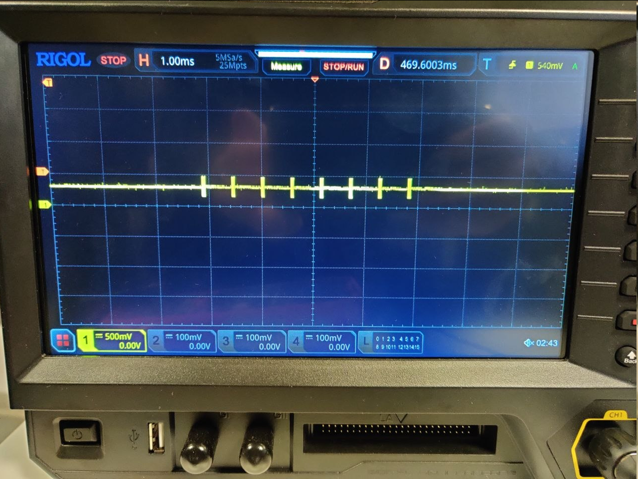

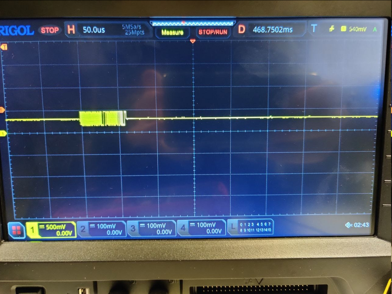

Because 0xF4 register AUX_RPLY_TOUT bit set, it is related failed aux communication.
To investigate this, an EDID request over AUX script was written and verified on the TI J722S EVM. On the J722S EVM, we also measured the AUX channel pins with an oscilloscope and could see both the AUX requests and the corresponding responses.
On our custom board, however, we can see AUX request activity, but we do not see any AUX response from the monitor side.
Consequences requests with no response
Could you please help analyze the I2C dump?
1. After the bridge sends an AUX communication request, what should happen next?
2. What are the possible reasons for an AUX communication failure?
