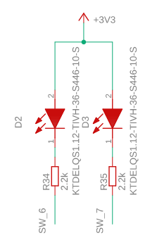

    1. DP83TG720 should be strapped in autonomous mode (Pin 6 pull down). Please follow configuration of DP83TG720EVM-MC:

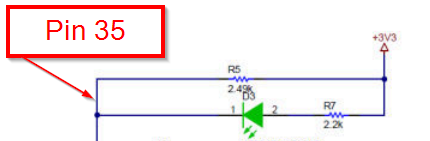

    2. If you intend to set DP83TG720 in master mode, pin 35 should be pulled up with 2.49k resistor. Please follow circuit below:

  • Hi Charles-san,
    >1
    According to the datasheet, when the strap mode is set to 1, the strap resistor is listed as open.
    Should this be configured as a pull-down resistor?
    >2
    Understood.

  • Hi  Kawamura-san,
    >1
    The logic level sampled by the strap determines the active state of the LED output driver. In Mode 1, strap will sample as pull-down because of pull-down internal to PHY. LED will not function correctly if it's pulled up as shown in your schematic:
    Please follow figure 16.9 in the datasheet for strap config with LED.

  • Hi Charles-san,
    I understand. A pull-down resistor is required in parallel with the LED on pin 6.
    Since I intend to use pin 35 in slave mode, does that mean a pull-down resistor is required there as well?
    Also, I assume switching to pull-up mode via SW1 requires changing the pull-down resistor connected in parallel with the LED to a pull-up resistor as well?
    Kawamura
  • Hi Kawamura-san,
    Please follow the strap configuration shown in Figure 6-19 for all LED pins that are use for bootstrapping.
    Since pin 6 and pin 35 on DP83TG720 should be strapped as pull-down, follow the pull-down strap with LED configuration shown on the left of Figure 6-19.
    I'm not sure where SW1 is on your schematic. If SW1 is an LED pin with strap capability, please follow LED configuration shown in Figure 6-19.
