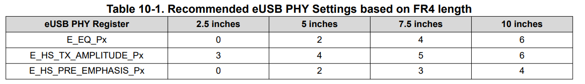

Could you help me to understand the definition of table 10-1? Looks like it recommend different setting based on different distance.
From 2.5 inches ~ 10 inches, does it means the distance from eUSB2 HOST to eUSB2 repeater?
Or it means the distance from eUSB2 HOST to eUSB2 device?
