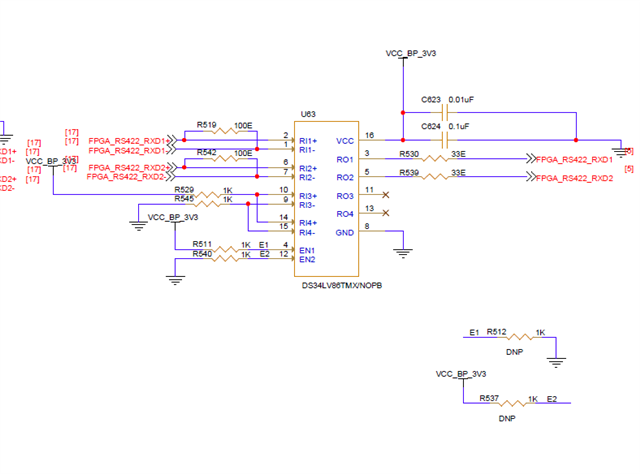

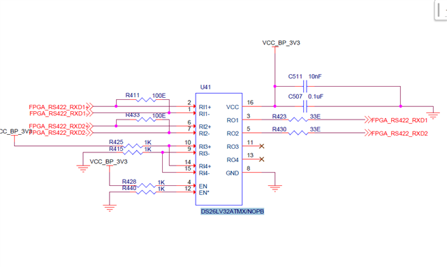

We have used the DS26LV32ATMX/NOPB part in one of our projects. Could you please suggest an alternative drop-in replacement for this component? Also, kindly confirm whether the DS34LV86TMX/NOPB can be used as an exact drop-in replacement in this case.
