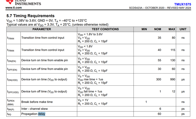

I only see that datasheet shows the part support BW up to 250MHz. But I don't see the delay time between IN/OUT port. May you help confirm the spec for our referece?

The timing characteristics we have spec'ed for this device are T_TRANSITION and T_BBM.
Transition time is defined as the time taken by the output of the device to rise or fall 10% after the address signal
has risen or fallen past the logic threshold.
TBBM is the time delay between the break and the make is known as break-before-make delay.
