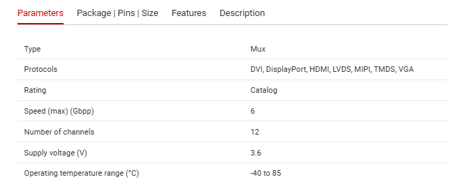

We are looking for high speed MIPI CSI-2 1:2 MUX for our design. Does TS3DV642(Non-AEC part) supports MIPI CSI-2? We couldn't find any reference for the MIPI CSI support in its datasheet but it was mentioned in its products basic information page.
Can you confirm whether TS3DV642 also supports MIPI CSI-2?

  • Hi Arya,
    But we could find MIPI CSI-2 Support in TS3DV642-Q1? Any interface and spec wise change between automotive grade and standard grade (TS3DV642)
  • Hi Selvaganapathi,
    I believe the reason as to why the Automotive version shows this is because MIPI CSI-2 is a common automotive protocol. There is no specification changes between the TS3DV642-Q1 and TS3DV642; The main difference is the operational temperature, the non Q1 device is rated to 85C while the Q1 is rated at 105C.
