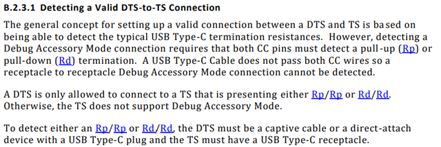

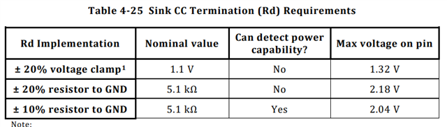

What resistor values must be placed on the CC1 and CC2 lines in order for the TUSB422 to set its DEBUG_ACC_CONNECTED bit in the Power Status Register?
