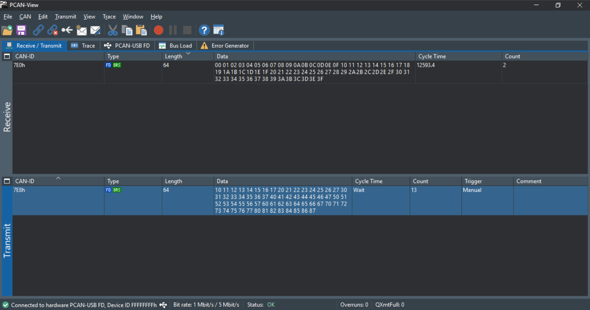

Hi Texas team,
        The datasheet mentions a data rate of 1 Mbps, but it supports FDCAN with a data phase rate of up to 5 Mbps. image.png
  • Hi Venkata,
    Yes, higher should be possible if conditions are minimal.
    However, in real-world use cases similar to section 11.2.1.3 per the Bus Loading, Length and Number of Nodes - 1 Mbps is recommended, thanks.
