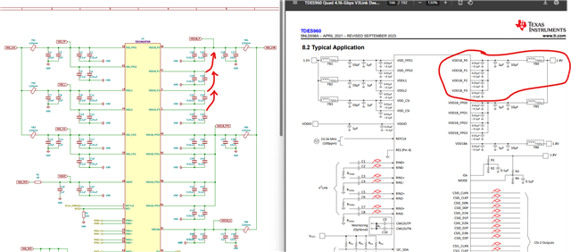

Hi, when we connect Arducam Tdes960 our device can detect it by I2C. When we connect our hardware TDES960_V1.0.pdf it does not detect I2C. All voltages are correct. And we have changed I2C 1.8V & connect 1.8to3.3V to PDB pin but could not detect device, 25MHZ ossilation can be seen with ossiloscope. Can any body help to us to fix? Thanks.Screenshot 2026-04-22 at 13.47.39.png

  • Hello Betul,
    Based on the schematic, it doesn't seem like the VDD18_P1/2/3 pins are connected to a 1.8V rail. I don't see a net name that ties them to a 1.8V rail.
    Justin Phan
  • Hi Justin, I hope it is the reason let us try tomorrow and let you know, thanks for your attention:)
    It might be the reason you think?
  • Hello Betul,
    Yeah, that is what I think is the most likely cause. You can try to solder the a wire from the capacitor to the 1.8V rail. This will probably be a bit hard, depending on your layout. And this rework will cause some extra noise at the power pins, but hopefully you are still within the datasheet noise specification. It might be able to get the chip to power-up.

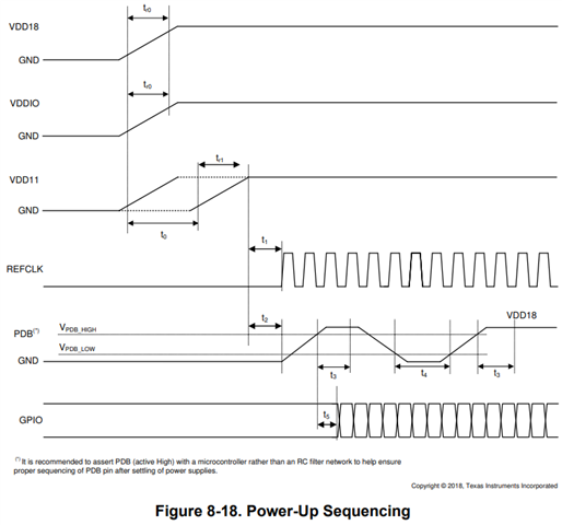

    Besides that, make sure the Power-Up Sequence can be followed.
    Justin Phan

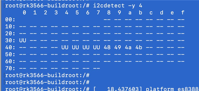

  • i2cdetect -y 4
         0  1  2  3  4  5  6  7  8  9  a  b  c  d  e  f
    00:                         -- -- -- -- -- -- -- --
    10: -- -- -- -- -- -- -- -- -- -- -- -- -- -- -- --
    20: -- -- -- -- -- -- -- -- -- -- -- -- -- -- -- --
    30: 30 -- -- -- -- -- -- -- -- -- -- -- -- -- -- --
    40: -- -- -- -- -- -- -- -- -- -- -- -- -- -- -- --
    50: -- -- -- -- -- -- -- -- -- -- -- -- -- -- -- --
    60: -- -- -- -- -- -- -- -- -- -- -- -- -- -- -- --
    70: -- -- -- -- -- -- -- --
    Now it detects I2C, we will keep working on it and let you know. Thanks for your help.
  • Sounds good. That is the right address, based on your IDX settings. You should be able to communicate.

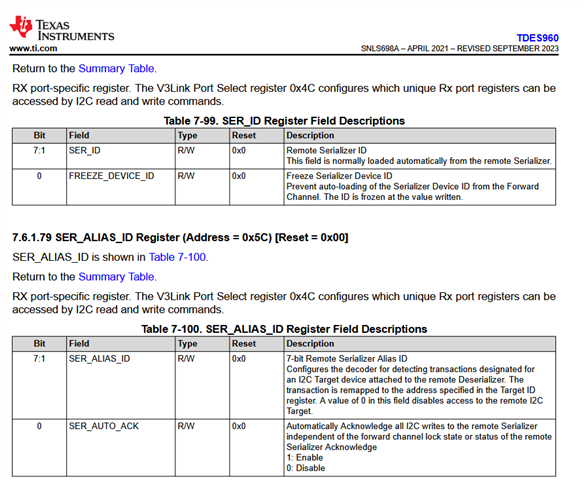

  • Hello Betul,
    At the very least, you should be able to detect the TSER953 serializer at power-up. Once you power-up the TDES960 board, you should be powering the TSER953 and the image sensor through PoC. The I2C address of the TSER953 should be visible from the TDES960 I2C bus if everything is powered-up correctly.
    Some debug steps:
    1) Do you know what MODE setting is on the TSER953? This is determined by the voltage divider network on the TSER953 MODE pin. The MODE setting on the TSER953 and the TDES960 need to match, in order to get LOCK at power-up.
    2) If you set 960 reg 0x4C = 0x01, you are looking at the RX Port 0 registers on theTDES960. Make sure that the camera module is connected to RX Port 0. Then, read registers 0x5B and 0x5C on the TDES960.
    If your TDES960 and TSER953 are properly powered-up and LOCKed, then the SER_ID should be populated with the I2C address of the connected serializer.
    Justin Phan

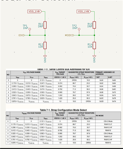

  • By the way this is our
    MODE& IDx Selection

  • Hello Betul,
    MODE& IDx Selection
    Yes, I saw this. I am asking you to confirm the IDX and MODE settings on the TSER953 serializers. To make sure that the MODE settings on the SER and DES match.
    If our layout has problems, would it prevent the TSER953 from achieving a LOCK entirely, or would it only cause MIPI errors?
    Yes, if your layout has issues, it can cause connection issues. Our SerDes devices have Insertion Loss and Return Loss limits. Your layout needs to follow strict high-speed layout guidelines, in order to make sure that the SerDes devices can LOCK onto each other. If the serializer cannot be detected, then one possible cause is that there is too much loss on the high-speed channel, which means the SerDes devices cannot LOCK onto each other.
