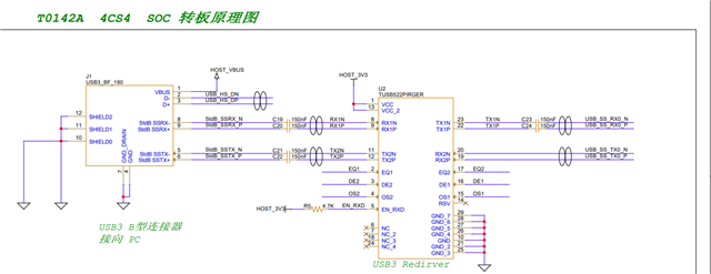

Hi, i haven't worked with USB3.0 before and i have a novice question on the Tx/Rx connections coming from the host (upstream) and then connecting to the downstream device.
Based on the block diagram figure 7.2 it seems logical to me to have the following the connection:
host Tx -> Rx1
host Rx <- Tx2
Rx2 <- SoC Tx
Tx1 -> Soc Rx
However, every reference SCH i've seen has the following:
host Tx -> Tx2
host Rx <- Rx1
Rx2 <- SoC Tx
Tx1 -> Soc Rx
i marked up the block diagram showing what i think the connection would be.  This connection does not match ref schematics but i can't understand why a Host Tx would route to a transmitter and not a reciver
