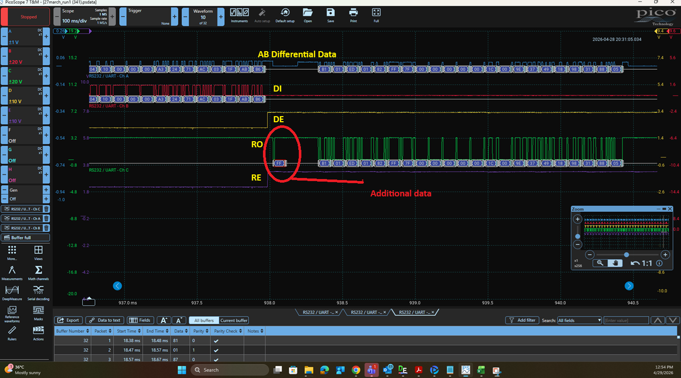

ISSUE: RO shows additional data which is not on RS485 AB bus (See image-1)

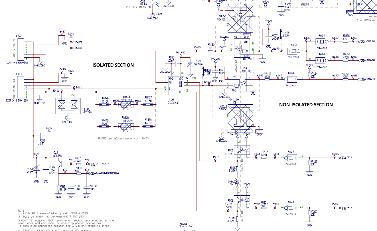

Setup shown below
Schematics shown below

    Precise timing image when R pin driven low is shown below
    RE ON to Additional data FF - 36us
    Additional data Pulse width - 12us
    Hope images are ok now. Let me know if anymore details needed

    Now that I am looking closer, I am seeing several inconsistencies with your waveforms.
    You might have the A/B probes setup incorrectly. You either have them switched or the math function has the A-B math backwards. When D=high, A-B should be high.
    Second, I see that when the DI line is toggling, and it is being reflected to the A/B pins. However, according to your waveform, DE is disabled. This does not make sense if the driver is disabled.
    Additionally, the RE pin has inverted logic: /RE. In your waveform, when /RE goes high (meaning the receiver is disabled), we see the R pin toggle. Please double check your labels.
    However, the ~10-12us time when R is low confirms it is the failsafe timer. There must be enough capacitance on the bus such that A/B differential voltage dips low enough to trigger the timer. The app note I linked directly applies to your situation. It looks like when the A/B pins drop to ~0V it briefly enters the undefined receiver region (VTH- < VOD < VTH+).
    I would collect another waveform fixing the issues I mentioned, and zoom in on the A/B bus pins right at the time the R pin drops low. My guess is that high->low transition on the A/B pins either has some noise present or there is significant capacitance such that there is enough time for the failsafe timer to trigger.
    One potential solution would be to enable your receiver after that A/B transition occurs (allowing the bus to dissipate).

    For the above reasons, i have probed on below locations
    As requested, i have attached a zoomed image of AB at the time of FF data observed
    As you said earlier, i have added additional delay between DE disable and RE Enable. Increased delay from 2us to 35us.
    Long run has been in progress. No additional data "FF" observed till now.
    Will update if any findings. Meanwhile let me know if there are any other findings at your end
