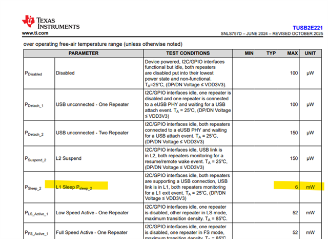

From my understanding that the Modern Standby Mode refer to the L1/L2 mode in TUSB2E221.
But may I know what's the power consumption of VDD3V3 & VDD1V8 at this moment?
And just to clarify the overall power consumption of the TUSB2E221 under Modern Standby Mode, should we use the 6mW for reference?
Please correct me if my understanding is wrong.
