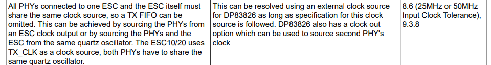

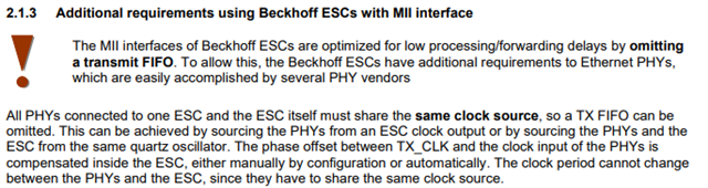

We are using two DP83826E phys, one being IN and one being OUT for EtherCAT. We are using two seperate oscillators for the X0 and XI that are the same circuits. Is there any concern with having two different clocks?
In this document it recommends having -How and Why to Use the DP83826 for EtherCAT® Applications (Rev. C)  image.png
