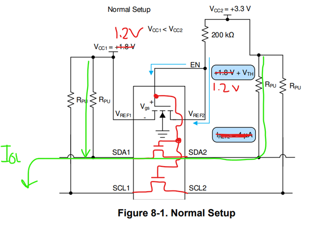

  • Hi Xujunfeng,
    The TCA39306 is a pass transistor solution. This requires pull-up resistors on both sides of the level translator.
    For 1.2V to 3.3V, the device should be connected in "level translation mode" with pull-up resistors on side 1 and side 2. This is required even with integrated pull-up on the controller.
    Is this chip still a viable option for an I3C application?
    It is viable, depending on your cap loading and systems requirements, you may have to use this device at a reduced data rate for I3C.
    If yes, how do I calculate the appropriate value for the external pull-up resistors?
    • Context:I've calculated the total load capacitance on both sides of the chip to be around 22pF. What should I consider next to determine the resistor values?
    I would design for max pull-up resistance equal on both sides.

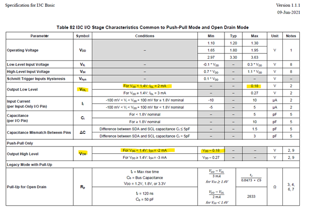

    I am referencing the I3C basic 1.1.1 spec.
    Because TCA39306 is not a buffer, the sinking current on side 1 and side 2 will combine:
    For example, if you choose 1k PU resistors on both sides, your effective sink current (assuming perfect drivers):
    IOL = (1.2V / 1k) + (3.3V / 1k) = 1.2 mA + 3.3 mA = 4.5 mA
    4.5 mA is outside the I3C spec for VOL/IOL and VOH/IOH. The current should be limited to <2mA. Thus you may need to select resistors that are weaker depending on the driver characteristics on the I3C host controller and I3C target.
